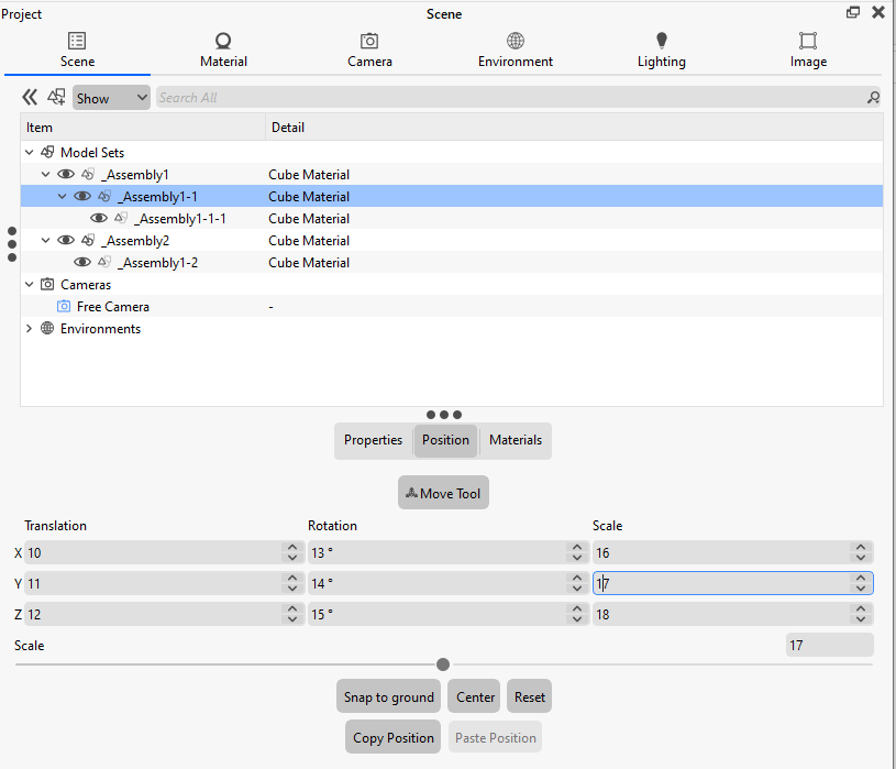

I would like to get the position of the image node "_Assembly1-1" via a script.
Hi community:
I have tried with this code, but it does not work when the node is inside a tree:

The output is:
Scale: (115.17648682504714, 136.1506659623152, 157.35782650841944)
RotationDegreesX: 21.194303453776122
RotationDegreesY: 21.138110103009087
RotationDegreesZ: 24.730497434905253
Translation: (71.83354208050602, 90.13889263596329, 110.34125451677617)
which does not correspond with the image data.
